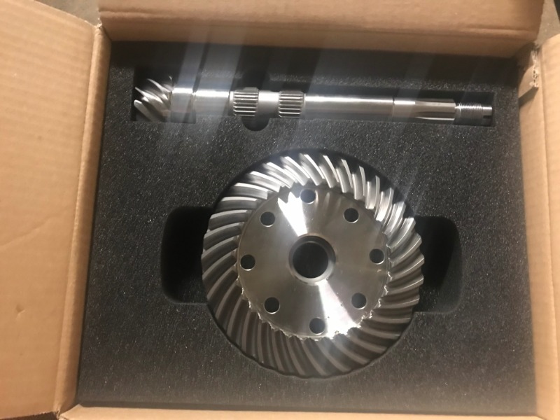

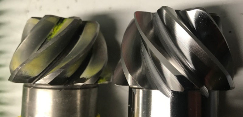

Hello, i see you have GT 40 replica with Rover V8 and SM transmission. Like in Lotus Esprit, engine in the back and rotates in opposite direction. Therefore you have 5 speed forward gears
However, gearbox runs also in opposite direction. Not good for crownwheel and pinion. Will be dragged into differential, wich will eventually brake. I have special reversed cwp sets for Lotus Esprit
and could be very interesting for you to.
